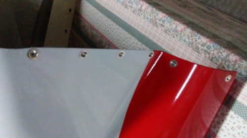

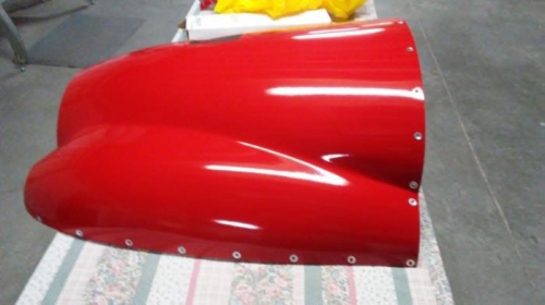

Stainless steel countersunk washers were glued to the mounting holes in the upper and lower cowling with E6000 adhesive.

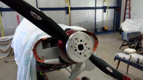

The propeller was remounted, torqued to specs, and safety wired.
Upper Cowling
Lower Cowling Rear Edge
Remounted Prop
