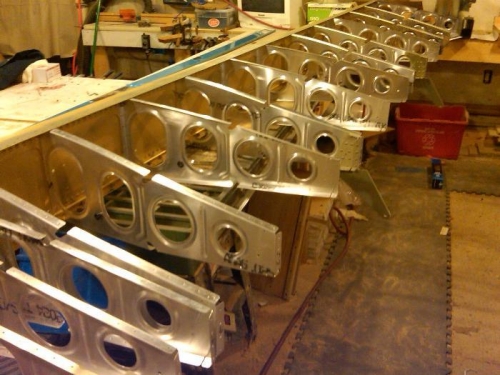

Riveted ribs to wing spar

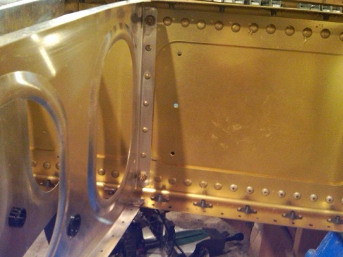

The instructions said to rivet the foward-most hole of ribs 2-8. I also riveted the ribs to the spar in this step also and installed the AN3 bolts.
For the seven flange rivets I had to use - 4 rivets becase I had countersunk all of them to accept the dimpled skins ., . . and these were too deep.
Had to use -4 instead of -3
All Riveted
Installed the AN3 Bolts
