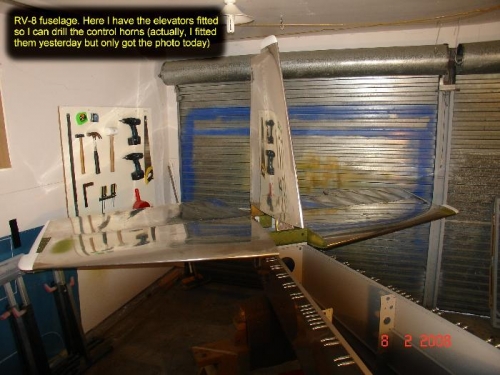

After a short TV break I decided to go out and take a quick look at what was next. An hour and a quarter later I had the elevators fitted ready for drilling the elevator horn tomorrow night. Its a real struggle to see what size and number of washers you need between the elevator control horn and the VA146 bearing because the vert stab spar is in the way and you can't see. Not to mention how tricky it is to actually get the washers in there in such a limited access area.
Anyway, here's a little trick: get all your drill bits in as close sizes as possible; I have a full set of metric and imperial. Now keep passing the shanks of the drills between the bearing and the control horn until you find one that *just about* squeezes through. Take your digital calipers and measure it. In my case, both sides, it was 3/16", or 0.185" in decimal. Now build a washer stack, including the big flat one that sits next to the bearing, until you get as close as you can to your measured size. Remove the big one, and place the remaining AN960-416(L) washers on the shank of a 1/4" drill bit. Use a dab of superglue (just a dab!) to hold them together and wait until the glue is fully dry (usually around 30 seconds or so).
Now place the single washer stack into your Avery washer wrench/holder and insert into the gap using a smaller that 1/4" drill bit or some
