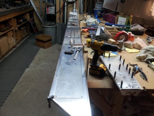

After many weeks waiting for the replacement part for the ruined spar cap to arrive, I did the unthinkable, and started on the LH spar....with lots of worry!
1) this shows the initial lay out of the spar prior to any drilling of the caps. ( One will notice the damaged spar for the RH side laying forelornly under tools). I have made spacers that yield spar distance top to botton of 197.3, +or - 1 or maybe 2 mm.. this is per the plans, and Kerry has confirmed the dimention for scratch building as correct. So...

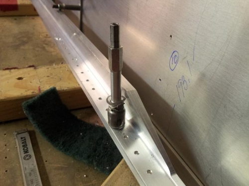

2) I made a tool that would allow vertical allignment to be maintained while counter sinking holes as needed under the angled sides fo spar caps. the plastic tubing is the stop.
