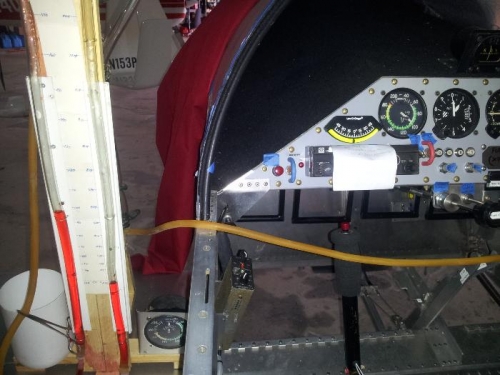

1) This is the actual test in progress and if one looks closely the ASI shows Really close to 100 mph, and the manometer shows the same...very close to 100. measured

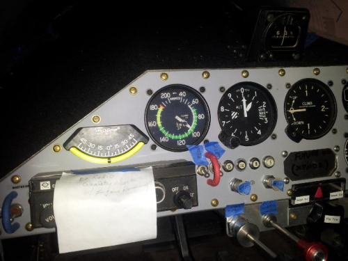

2) A better look at the ASI, paralax not withstanding...99+ MPH. not bad at all. I did not think...until now!...to take pix of the 40, 120, and 180 mph tests, but they were just as accurate and the 100 mph test, with excellent linearity. It will be my butt in the seat so I am not fudging here, believe me!

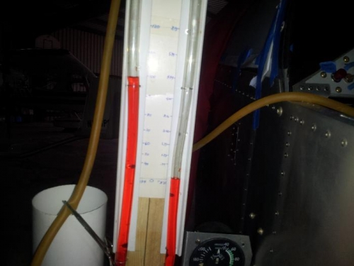

3) A relatively closer view of the manometer, with the scale set to the bottom of the right tube, and the left side fluid lever is exactly opposite the scale marker for 100 mph. ( I know its hard to see and if I could figure how to blow it up I would have).

Overall view

100mph indicated

100 measured
