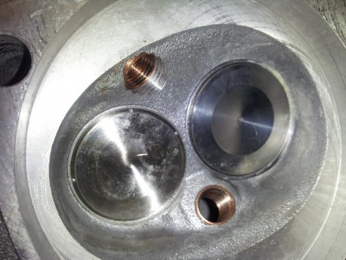

10 At first look the threads looked fine and cleanly installed
2) But when I saw a small bit of ectended threads into the chamber, I invisioned a hot spot that might cause pre-ignition when engine was hot and under power.

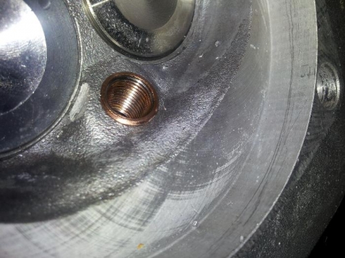

3) Close up of same.
