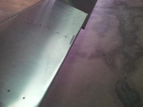

One of the small mentions Mel said was the trailing edge of the ailerons were not flat enough and would eventually break the skin around the last rib rivet. He told me how to correct this with a hand seamer and some cushioning, which I did. this is the result...no wavyness in the reflection of the TE. Thanks Mel!
fixed
fixed
