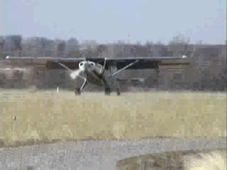

Pretakeoff.
Pretakeoff.

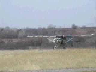

Takeoff.
Takeoff.
Landing.
Landing.
