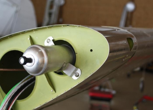

I installed the previously cleaned up C150 wing vent for the left wing. Unlike the right wing, I had to trim off 1/2 inch of the elbow in order to get the vent inboard enough so that the brackets would engage the inboard rib. Nutplates were installed on the rib in order to secure the bracket.
Wing cutout.
Wing cutout.
Root view.
Root view.
