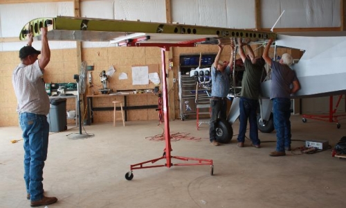

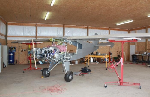

I asked a few friends to come by and help mount the wings. I used the 3/8 inch bullet bolts to mount the front spar to the fuselage, and the 3/16 inch bullet bolts to pin the aft spar. It was actually fairly easy, with all the help.
Cranking up the drywall lift.
One person can balance the wing.

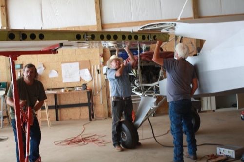

Ready to drill aft spars.
