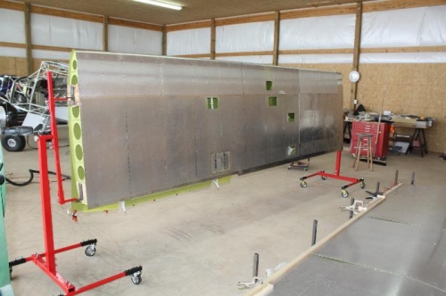

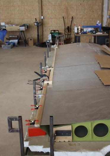

The fuselage is more or less ready to fit the wings, so it's finally time to get the wings out their packing crates. I assembled the Bogert wing rotators, and mounted the right wing. I fabricated poplar 1 x 2 strips to protect the skin edges; I attached them with 6/32 screws and #10 washers when I could go through existing rivet holes, clamps when I couldn't and glued some connecting pieces. There was a lot of styrofoam to clean up, too.
Applying poplar edge protectors.
Bogert wing rotators.
