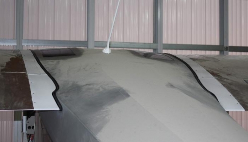

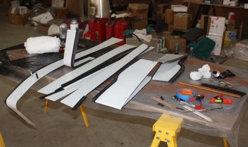

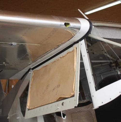

Brief Description:  Wing Root Fairing Weatherstrip Install
I applied 1/16 inch x 1/4 inch self-adhesive tape on the mating surface of the wing portion of the wing root fairings, and channel on the fuselage portion. I largely used AC Spruce E-Channel P/N 05-00599 with the exception of the fairing immediately over the front doors, where I used AC Spruce Rubber Channel and Moulding #4 P/N 05-01500. I overlapped the forward fairing channel 3/4 inch in non-cemented fashion onto the aft fairings. 3M Weather Strip adhesive was used for securing the channel. I then installed the fairings.
Neoprene tape and weatherstrip applied.
Lower wing root seals.
Upper wing root seals.
