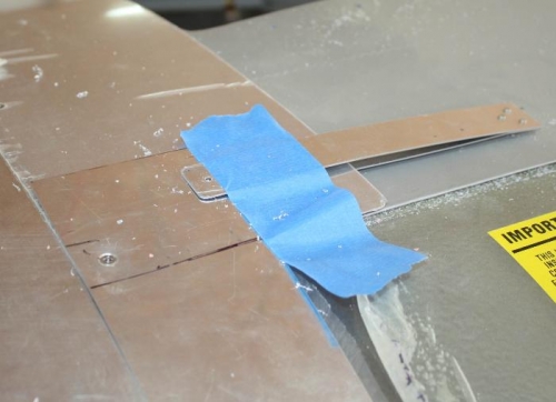

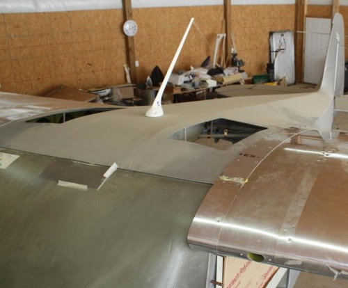

I made the upper wing root fairings out of .025 inch 2024-T3. I'd previously installed dimpled 6-32 nutplates on the inboard edges of the wing, and I used homemade hole finders to copy the hole onto the fairings. I overdrilled the the fairing holes with a #27 drill bit and dimpled them. After the outboard edge of the fairing (inboard edge of wing) was finished, I drilled #40 holes in the fuselage channel, and used the hole finders to copy the hole onto the inboard edge of the fairing. I then redrilled the channel with a #38 drill bit and tapped the channel to 6-32. I then over drilled the inboard fairing holes with a #27 drill bit. I drilled an additional hole in the forward fairing, dimpled it and placed a nutplate on the upper fairing so that the leading edge of upper fairing would be well secured.
Copying fuselage channel hole.
Right upper wing root fairing.
Left upper wing root fairing.
