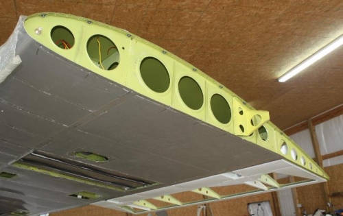

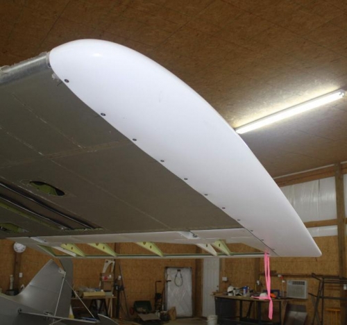

I installed rivets in the outboard rib as well as the nutplates for the wingtip and trimmed the front of the rib, so as to allow the wingtip to fit better on the left wing. I then drilled the wingtip to match the nutplates and countersunk same and installed the left wingtip using #6 Tinnerman washers. This side scallops, too.
Nutplates installed.

Wingtip in place.
Wingtip in place.
