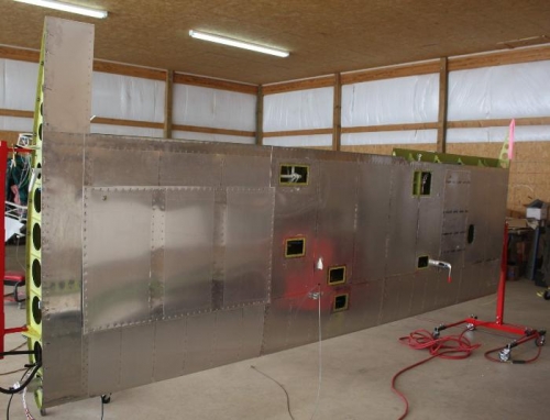

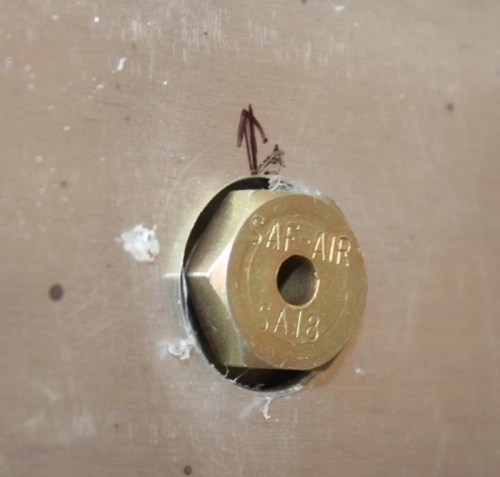

I installed the fuel tank access panels, marked them where the drains would go, and drilled them, successively enlarging the holes so as to keep the Unibit centered.
Close up of Saf-Air drain.
Fuel tank access panels and drains in place.
