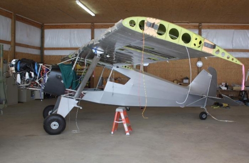

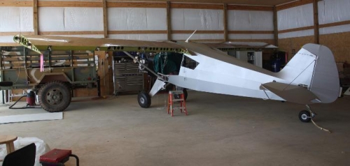

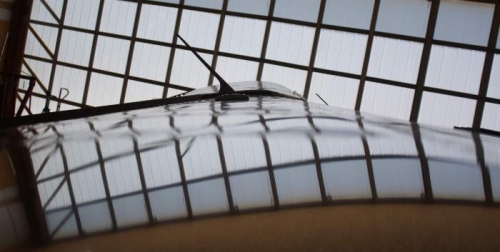

I rounded up three helpers and we mounted the wings for (I hope) the last time. One -6 washer was used aft of the wing on the forward spar and two each -5 washers, one forward and one aft of the rear spar. The struts were mounted as well.
Wingtip View.
Rear Quarter View.
Upper wing surface view.
