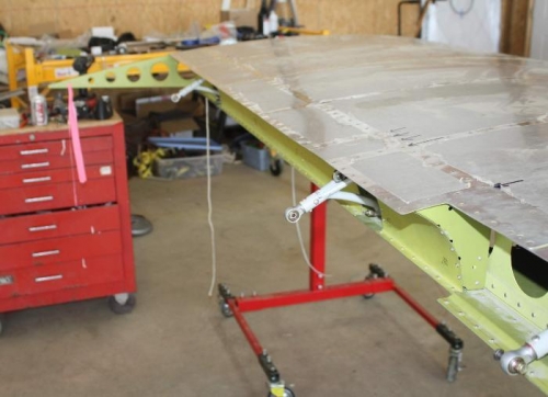

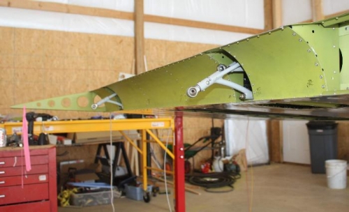

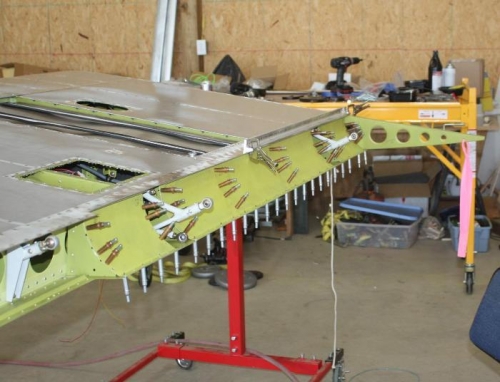

On the left wing, I completed marking out the lower wing surface to match the pocket ribs and drilled out the rivet line, and then followed that by a brief burst of deburring and dimpling. I then riveted the pocket ribs to the upper and lower wing skins using the squeezer. Finally, Avex pop rivets were used to secure the curved pocket rib surfaces.
Pocket ribs ready to rivet in.
Upper surface.
Upper surface.
Avex pop rivets.
Avex pop rivets.
