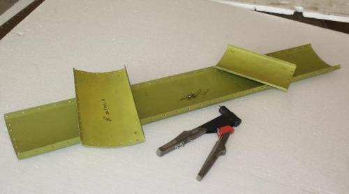

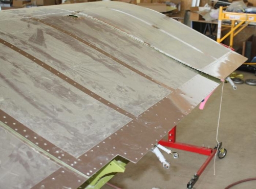

On the right wing, I trimmed the pocket ribs, and drilled the skin to interface with the upper and lower wing skins. After deburring, I dimpled the pocket ribs and skin. To dimple the pocket ribs, I found it necessary to use an Avery pop-rivet 3/32 dimpler on the bottom surface. I then removed the PVC coating from the upper wing skin along the rivet lines.
Drilling.
Drilling.
Pop rivet dimpling.
Pop rivet dimpling.
Drilled, deburred, dimpled.
