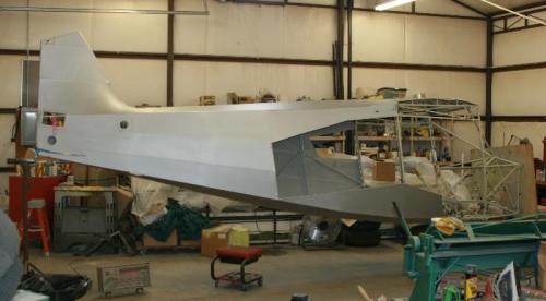

Brief Description:  Fuselage Spray 2
An additional coat of Poly-Spray, then 5 hours of wet sanding with 320 sandpaper and then a final coat of Poly-Spray. One of the trim fairleads put enough pressure on the fabric during sanding to make a small hole there; I repaired it with a round patch. The next morning, I removed the masking.
