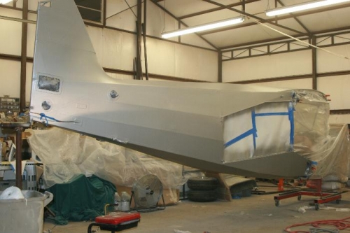

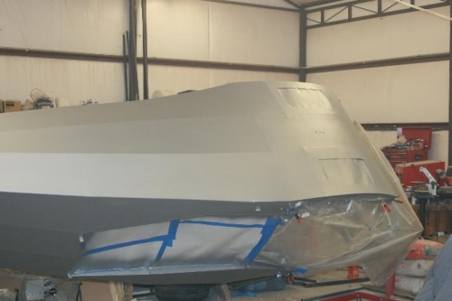

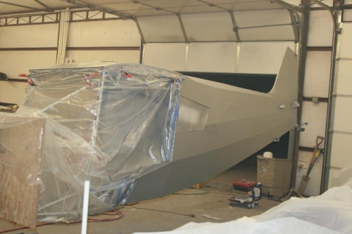

Date:  1-1-2009
Number of Hours:  6.50
Brief Description:  Fuselage Spray 1
Two coats of clear Poly-Brush, a once over of ironing the tapes and gusset edges again, and one coat of Poly-Spray. I had trouble with my first coat of Poly-Brush, as it made "cotton candy". I'd let the compressor run down, and started the compressor when I started to spray, making small wisps of dried vinyl, because of the warm air in the hose. I contacted Poly-Fiber tech support and they recommended wiping down with reducer, which got rid of most of the "candy". The rest should sand out during the wet sand phase after the next coat of Poly-Spray.
