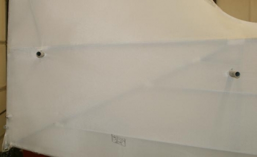

After shrinking and smoothing the glued edges with 250 deg (and making cutouts for the VOR antenna, skylights, and left rear window), I used a soldering iron to cutout the center of the protrusions for the tail and flap pulleys and right flap fairlead, and heat shrunk to 350 deg.
Protrusion cutouts.
Protrusion cutouts.

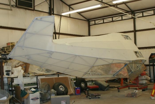

Right fuselage.
Right fuselage.

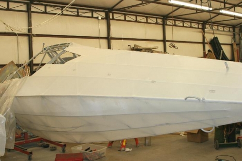

Left fuselage.
Left fuselage.
