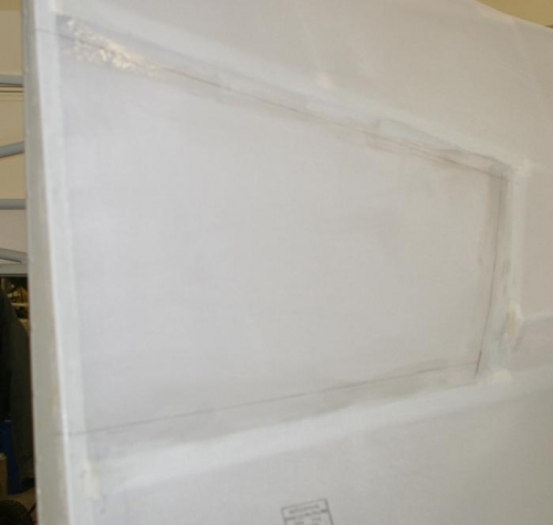

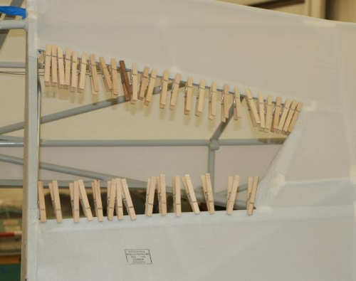

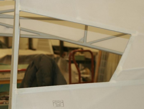

After shrinking the fabric to 250 deg, I glued the fabric to the edge of the window frame, cutout out the center, and glued the flaps to the inside of the window channel, followed by heat shinking in the channel.
Lines drawn and adhesive placed.
Flaps folded back and glued.
Cutout finished.
