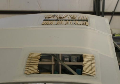

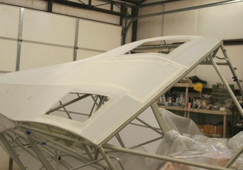

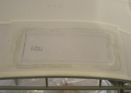

I made the cutout for the skylights; after shrinking to 250 deg, I made a one inch glue line on the top surface, cutout the center and folded and glued the edges to the inner surface.
Cutout lines drawn.
Clothespins to hold fabric in place.
Finished.
