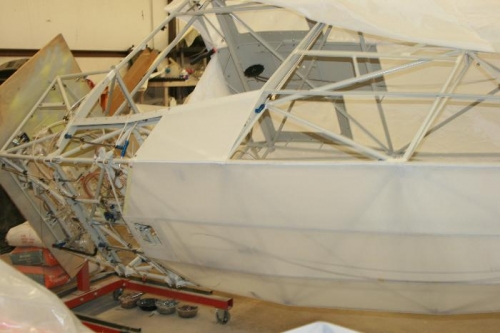

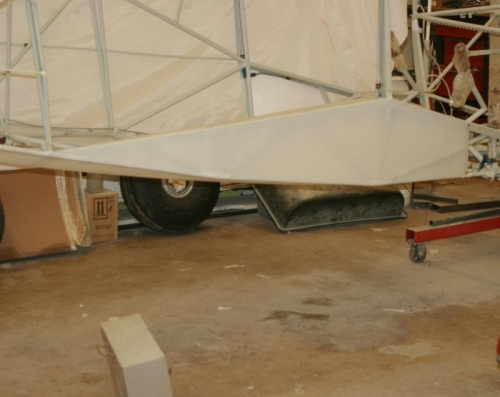

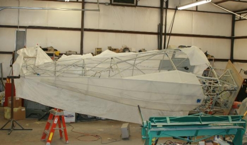

I prepped and covered the bottom fuselage with heavy Poly-Fiber fabric, and shrunk it after gluing the edges with Poly-Tack.
