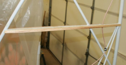

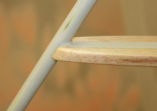

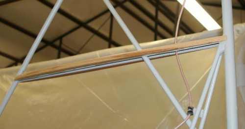

Brief Description:  Tail fin false rib
I made two false half ribs for the lower of the two tailfin ribs using a NACA 0205 planform out of two 36 x 3/4 x 1/2 strips of balsa on the bandsaw, applied marine spar varnish, and epoxied the two ribs to the tailfin rib.
