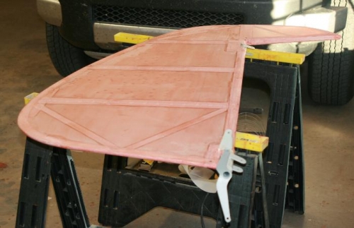

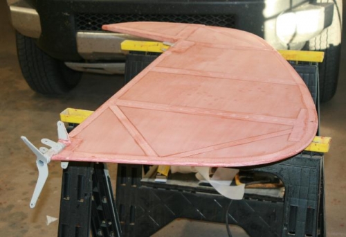

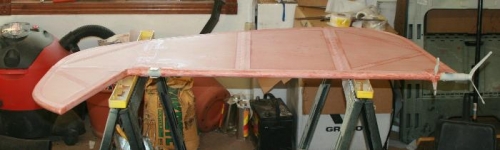

I yet again marked, applied a coat of Poly-Brush over the to-be-taped and to-be-gusseted areas, applied the linear tapes and gussets, ironed out the wrinkles, applied bias tapes, ironed out the wrinkles, and applied the final brush coat of Poly-Brush over the bias tapes, and burned the drain holes with a soldering iron. Next, I'll put up the paint booth for applying the two cross-coat Poly-Brush and the three Poly-Spray cross-coats.
Left rudder.
Left rudder.
Right Rudder
Right Rudder
Front view.
Front view.
