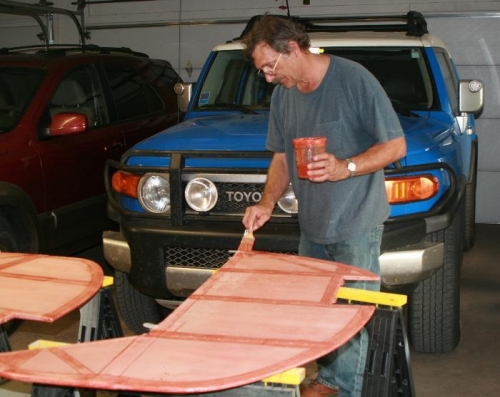

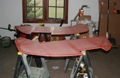

I marked, applied a coat of Poly-Brush over the to-be-taped and to-be-gusseted areas, applied the linear tapes and gussets, ironed out the wrinkles, applied bias tapes, ironed out the wrinkles, and applied the final brush coat of Poly-Brush over the bias tapes.
Self portrait.
Self portrait.
Final coat of Poly-Brush on tape.
Ditto.
Ditto.
