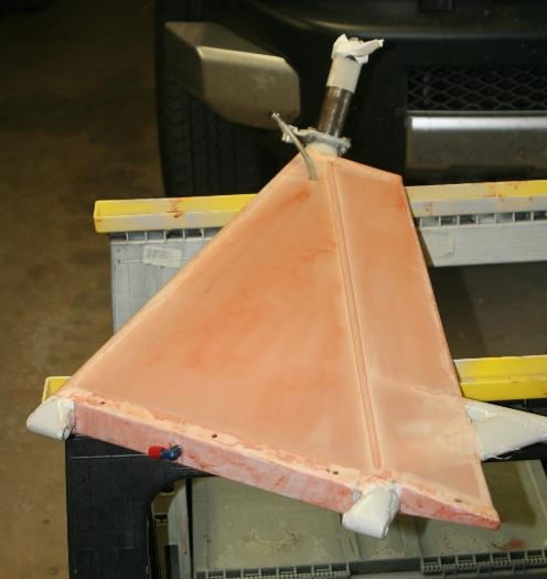

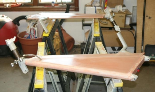

I degreased, placed anti-chaffe tape, trimmed and glued heavy Poly-Fiber to the gear legs, glued inspection rings and Poly-Brushed a dolly on the inner surface adjacent to the upper fittings, and applied a brush-coat of Poly-Brush.
Inner surface, left gear leg.
Both gear legs.
Both gear legs.
