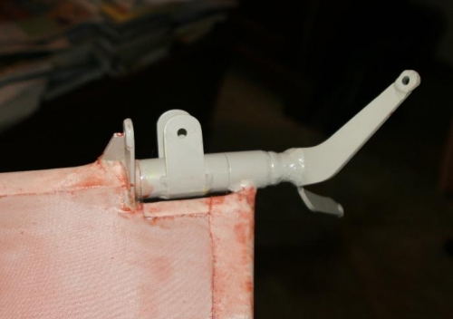

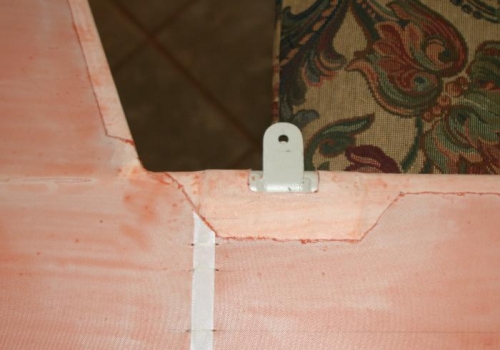

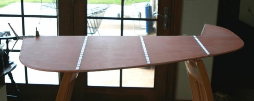

After making and alodining an aluminum fairing to fit over the upper hinge point in order to facilitate fabric attachment, I glued, trimmed and heat shrunk to fit the Poly Fiber fabric. This was followed by a brushed on coat of Poly Fiber and rib lacing.
Left Side
Left Side
Bottom Hinge Fabric
Bottom Hinge Fabric
Upper Hinge Fabric
Upper Hinge Fabric
