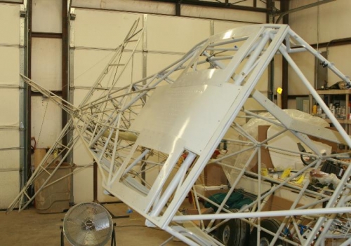

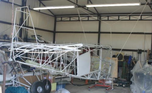

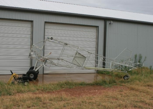

I installed the VOR antenna and aft static port tubing, side stringers, and reinstalled the fuel lines, then took the fuselage outside for a pressure wash, as 2 years of dust had accumulated since the fuselage was delivered. I then hoisted the fuselage up on a pulley system that I'd attached to the rafters of the shed, removed the landing gear and mounted the fuselage on the rotisserie, which will help with the fabric process. I then reinstalled the upper stringers and the skylight sheet metal.
After pressure washing.
Fuselage remounted on rotisserie.
Skylight remounted.
Skylight remounted.
