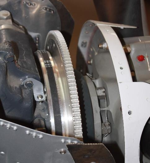

I reinstalled the propeller with the help of a friend. It turned out that a bracket that held a electronic ignition wire impinged on the flywheel, so I had to fabricate another bracket. I powder-coated it, as well. I then safety-wired the hub bolts using .032 inch safety wire after torquing them IAW Hartzell Propellor Owner's Manual 115N,Table 3-1. I greased them with Aeroshell #6 per the manual, too. The alternator belt was tightened and secured with safety wire.
Prop installed, alternator belt in place.
Prop hub safety wired, new electronic ignition bracket.
