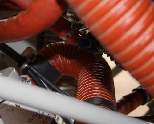

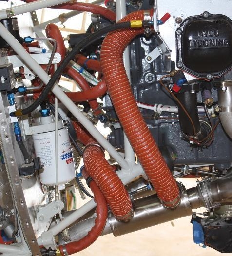

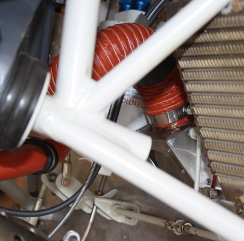

I trimmed and fitted SCAT tubing from the aft right engine baffle to the heat muff and to the heater valve. It was necessary to fabricate two clamps, covered with heatshrink, in order to control the ducting away from sharp pokey things as it made it's way to the heater valve.
Overall View.
Overall View.
Close up of duct straps.
Heater valve duct termination.
