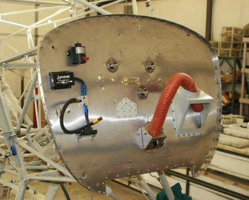

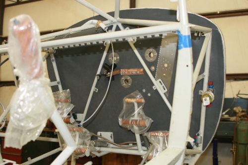

I completed determining locations of the various firewall components, removed the protective film; drilled, dimpled and pop-riveted nutplates, and installed Kool-Mat on the inner surface. I mounted as many of the components as seemed reasonable pending final installation of the firewall.
Cabin view.
Cabin view.
Engine side.
Engine side.
