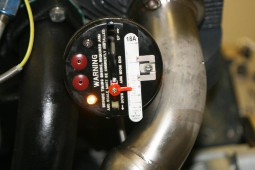

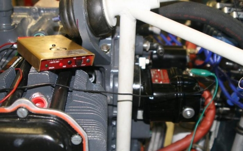

Not knowing what my magneto was timed at and needing to verify the mag position so as make sure there was no clearance problems with hoses, I used a Time-Rite to set the mag to the prescribed advance.
Time-Rite set for 25 deg BTDC.
Magneto synchronizer.
