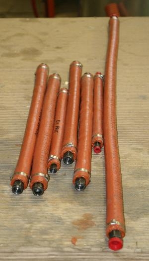

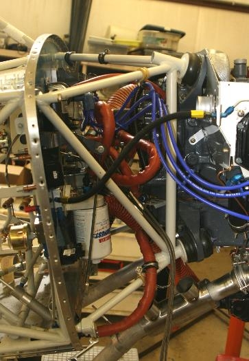

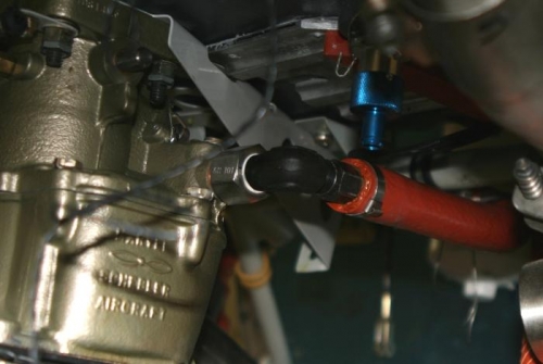

I completed making the hoses and installing oil cooler, oil filter, oil pressure sensor, primer, and carburetor fuel inlet hoses and their associated fittings; firesleeve was used and the ends of the firesleeve was dipped in hi-temp RTV thinned with MEK.
Firesleeved and ends dipped.
Right side hoses
Right side hoses
Fuel inlet hose
Fuel inlet hose
