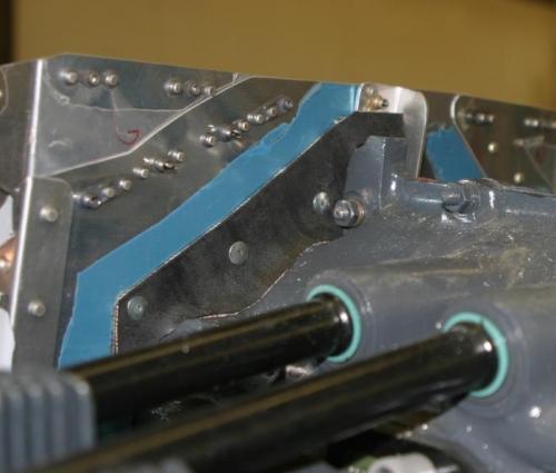

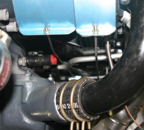

More work on the baffles. The center front baffle had seals added left and right and an additional strip of aluminum was added on the right to increase the fit and decrease cooling air pressure loss. The stainless rods provided by the Van's engine baffle were threaded and bent to fit.
Left front center baffle.
Right front center baffle.
Left tension rods.
Left tension rods.
