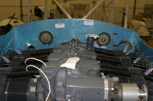

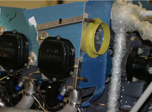

I riveted the doublers, heater and oil cooler flanges and assembled the aft and side baffles. A fair amount of trimming was needed around the oil pressure adjustment area. In fact, I wrongfully trimmed back the bracket which attaches the right aft baffle, because it looked too long. After trimming back enough sheet metal, I ended up making a new bracket.
