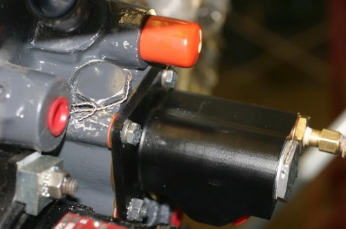

My engine came with an oil screen and no Vernatherm. Per Lycoming, I removed the oil pressure bypass piston and spring and then installed an ADC remote oil filter adapter which includes a Vernatherm. I also installed the Advanced Flight Systems oil temperature probe.
ADC oil filter adapter and temp probe.

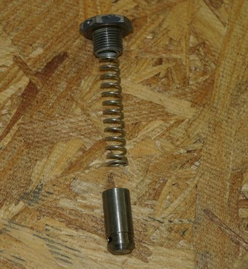

Oil pressure bypass piston and spring.
