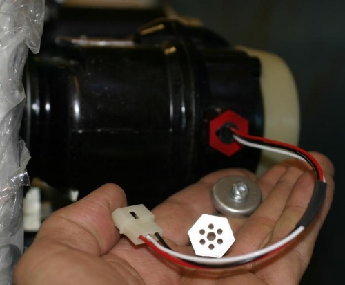

Brief Description:  RPM Sensor

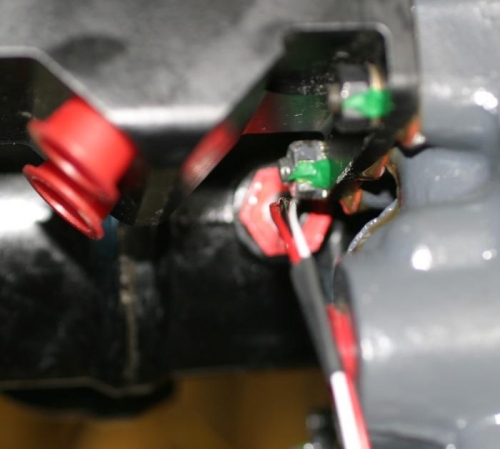

I'm installing an Advanced Flight System AF-3400 EFIS, and I replaced the ventilation port on the left Slick magneto per AFS's instructions, after first putting in the wrong vent (you're supposed to place the RPM sensor in the vent nearest to the block flange). It's in the correct one, now.
Wrong!
Wrong!
Correct.
Correct.
