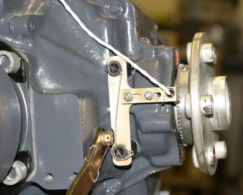

Brief Description:  Electroair Electronic Ignition 1
I installed the timing sensor for the Electroair electronic ignition. This system doesn't require drilling and tapping holes in the crankcase, unlike the Lightspeed unit. It was necessary, however, to relieve the bracket to clear the alternator bracket pivot bolt, and to remove that bolt, if needed, I will have to remove the timing sensor bracket.
Timing sensor from above.
Timing sensor from the right.
