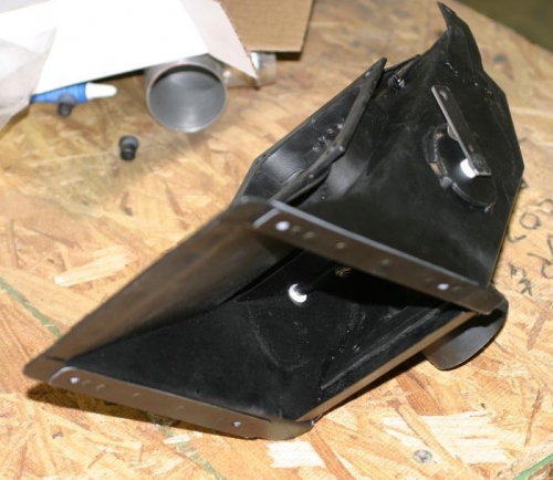

Date:  10-26-2007
Number of Hours:  2.50
Brief Description:  Carb Air Box2
