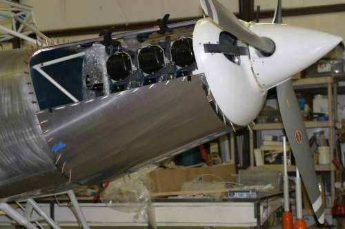

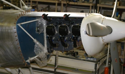

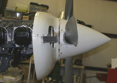

I secured the nosebowl to the spinner using 1/4 in spacers and a hot glue gun after centering the nosebowl onto the spinner; an aluminum strip was glued in place so as to account for rotation. The upper cowl skin was secured as was the bottom skin. The channels provided in the kit were too short for the upper skin and I fabricated new ones from .032 in 2024 aluminum.
Nosebowl Secured To Spinner
Upper Cowl In Place
Upper Cowl In Place
Lower Cowl in Place
Lower Cowl in Place
