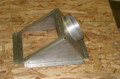

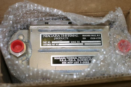

I ordered the oil cooler and mount from Van's; it's the same one used on the RV-10. I alodined the mount and did the necessary riveting and nutplate installation. I've ordered some bushing material and the appropriate length -3 bolts to securely fasten the cooler to the mount. I've also ordered the 3/8 NPT steel pipe-to-AN nipples.
Alodined, riveted and nutplates.
Niagra 2006a Oil Cooler
