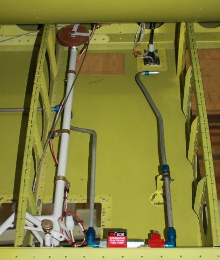

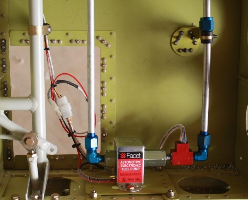

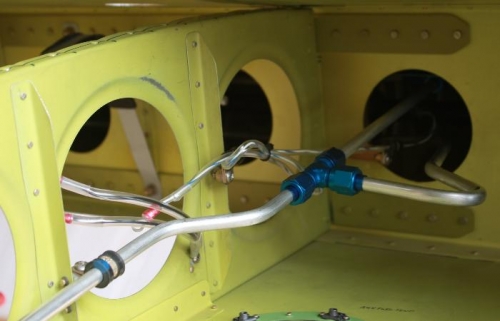

Additional details of wing bay wiring. Since I didn't ground the shield of the aux fuel pump sensor in the cabin, so I had to run a separate ground to connect to the shield.
Aileron bracket bay.
Aux fuel pump and sensor wiring close-up.
Aux fuel sensor bay.
