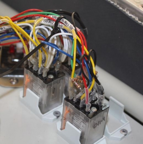

I completed wiring the annunciator dimming circuit, which uses a relay to switch a 150 ohm resistor into the light circuit when the Nav lights are turned on.
Completion of the dimming relay.
