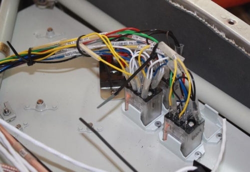

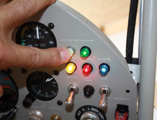

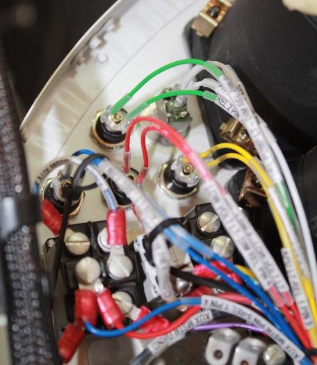

I wanted a set of annunciator lights for aux power, low voltage, external power, and fuel pump, with a non-master switch dependent push-to-test function, as well as dimming when the Nav lights are on. That ended up requiring three 4PDT relays. Everything is functional except for the dimming function, which isn't completely wired in yet.
Relay wiring.
Relay wiring.
Push to test function works!
Panel light wiring.
Panel light wiring.
