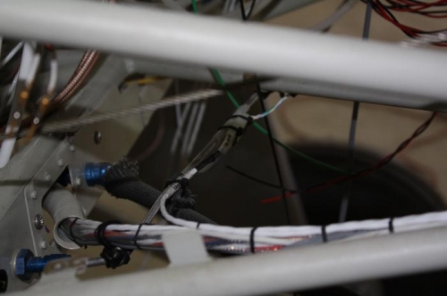

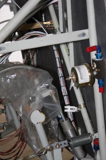

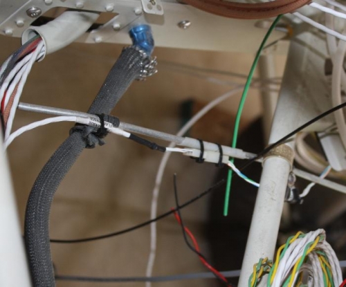

I fabricated a multiconductor cable to run the flap sensor wiring up to the boot cowl. I laced the floorboard wiring as it came out of the conduit up to the upper firewall, and used Koro-seal lacing to protect the cable as it crossed fuel or brake lines.
