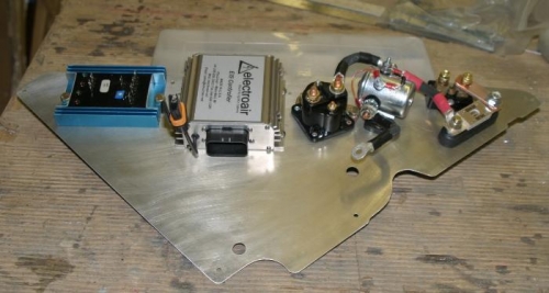

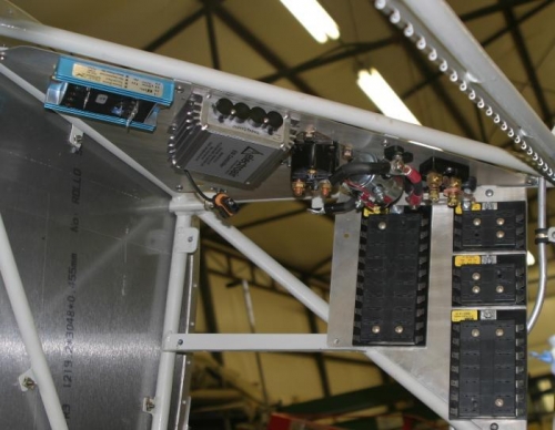

I had originally made a right subpanel and fuse panel, but after I made the wiring diagram and after all the components including avionics were selected, it became apparent I didn't have provision for enough fuses. In addition, the voltage regulator and electronic ignition controller required more room than previously alloted. So, new panels were fabricated. I ended up selecting Unswitched, Switched, NAV/COM Only and Avionics Buss fuse blocks of 6, 20, 6, and 14 fuses, respectively. The Master and Starter relays were mounted close to the fuse blocks in order to minimize heavy duty cable lengths, and the voltage regulator and electronic ignition control boxes were placed on the bottom for accessibility in order to aid troubleshooting and adjustment, respectively. Not shown here is a 25 amp diode mounted on the top of the subpanel. A resistor to stepdown the 12 volts to 5 volts for the 2 inch altimeter and a relay to provide annunciator relay dimming with activation of the nav light switch have yet to be mounted, but I'll wait until I'm actually wiring in order to select the best position for those items.
Upside-down view of the right subpanel.
New fuse arrangement.
Right subpanel and fuses.
