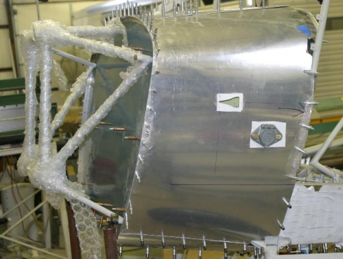

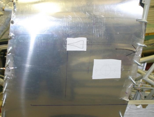

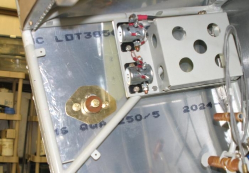

Brief Description:  APU and Avionics Cooling Inlet
Cutouts where made in the left boot cowl for an avionics cooling inlet and for an Piper-style APU jack. Aerodynamic flush style bolt heads where used for the APU jack (actually toilet brass bolts) to minimize drag. I'll mount the NACA inlet after I've removed the boot cowl for alodining, nutplates and priming.
Templates glued in place

Interior view
Interior view
