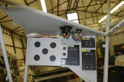

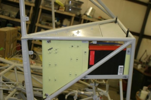

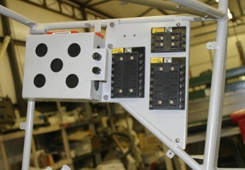

Brief Description:  Electrical Panel 1
I fabricated panels for mounting fuseblocks and the solenoids. I'm not really on board with the essential bus concept as I will use a Lycoming O-540 with at least one conventional magneto, and have a spare battery and battery contactor, as well. I do still believe in an avionics master and also like to have a "com-only" switch to listen to the ATIS and talk to clearance delivery prior to engine start, so that will be incorporated, too.
Outside view of main battery and panels
Mounted battery and fuse blocks
Starter and master solenoids mounted
